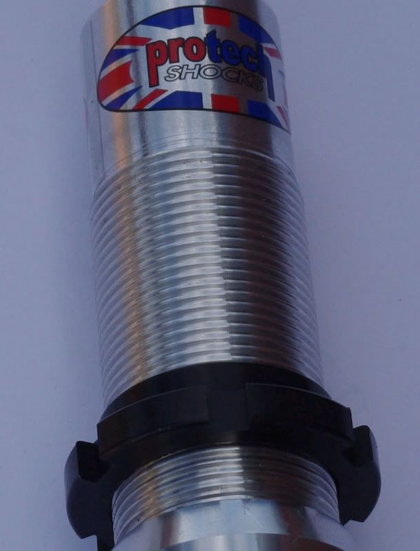

MikeCapon
posted on 6/4/12 at 09:13 AM Reply With Quote
Morning all,
There are a lot of misunderstandings around shocks and suspension simply due to the jargon not being understood.
Here are some definitions which will, I hope, help:
Preload
Preload is simply the amount by which the spring is compresssed when fitted to the shock with the shock fully open. Lets say you have a 9" spring. 228mm. If you measure the sping when it is fitted to the shock (with the shock fully open) and it measures 210mm you have 18mm of preload.
Preload is adjusted with the threaded spring seat seen below. More preload = raised ride height.
Ride height adjuster
A ride height adjuster is a means of changing the actual length of the shock. Usually a threaded end fixing with a lock nut
Both the preload and the ride height adjuster will alter the ride height. The difference between the two is as follows:
When a car is sitting at its static ride height (usually considered to be in its loaded condition) the shock will be neither fully open or fully closed.
Part of the movement (stroke at the shock or wheel movement at the wheel) will remain available so that the shock can close or compress to follow a bump on the road surface, a roll in cornering (outside wheel) or front dive under braking. This remaining movement is referred to as bump.
Equally part of the movement will remain available to allow the wheel to descend/the chassis to lift, to follow a dip in the road surface, roll in cornering (inside wheel) or lift of the rear shocks under braking. This movement is referred to as droop. (Sag on a motorcycle)
On a Seven type car the typical bump and droop values will be around 60% of the movement in compression and 40% in droop.
Increasing the spring preload will increase the available bump movement and reduce the available droop movement.
Using a ride height adjuster will only increase the ride height. The bump and droop values will remain unchanged.
I hope this helps. If it is not clear please tell me and I'll do my best.
To go back to the OP. The starting point for the preload is not a big deal. Bolt the shocks on the car with the spring seat in a postion that just starts compressing the spring (shock fully open). Lower the car to the floor, roll back and forwards about half a wheel turn and check the ride height. It will almost certainly be too low. Turn the spring seats until you get the ride height desired. Roll back and forwards each time before measuring.
