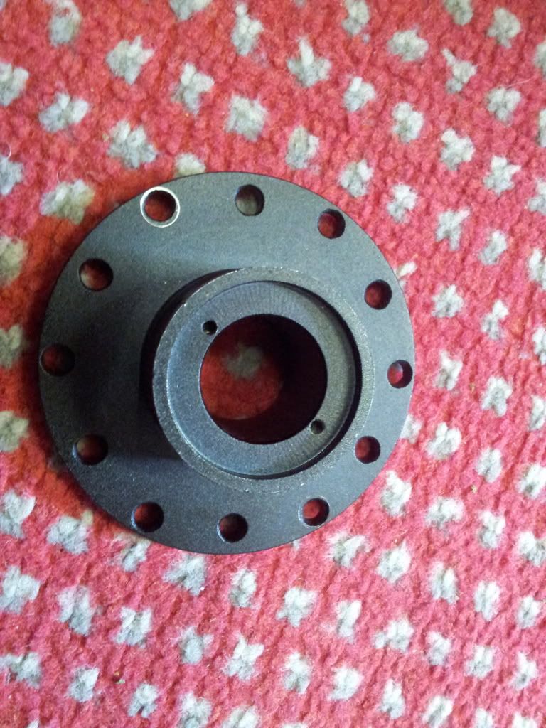

How to make a steering boss

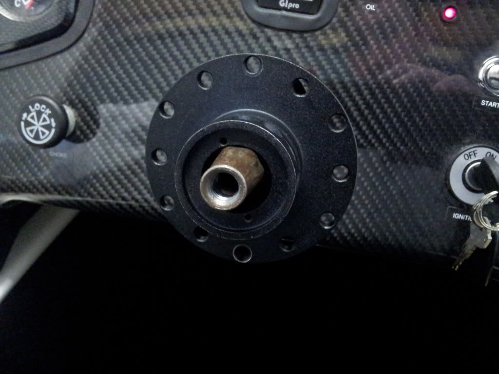

I want to somehow fix one half of my quick release steering boss to the column. As you can see the hole in the middle is bigger than the column so i need to fill it in and shape it to fit the hex on the end of the column. I have an adapter but it's too chunky and wouldn't look right. Anyone got an idea how i can do this?

Do you have an old sierra steering wheel?
Cut the centre boss out of that. I can't remember what it's made of though, if it's steel then just trim and weld in place.

Cut out a disk of mild steel of a good thickness and file out the hex shape? Bolt into the centre of the boss?

I do have an old wheel but i was going to use it for the iva than swap to a nicer wheel straight after. The quick release bit is made of ali i think the sierra one is too. I also wanted to cut the wide ring part off too just to make it neater.
