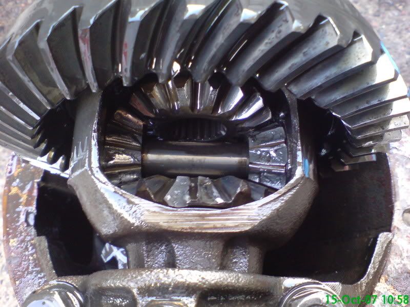

IT WAS THE DIFF!!
I'll go and get some piccies as soon as I persuade my toddler to stop painting the house with Weetabix.
This was a quick spin around the block just to see if the car would move under its own steam.....

Hi If using an english diff with anything over 150bhp. It would pay to have it built to competition spec including a solid spacer. Will then be good for 250bhp.
Cheers MATT
Coose
posted on 16/10/07 at 05:00 PM Reply With Quote
Cheers MATT
A solid spacer won't stop the planet gears from self-destructing!
