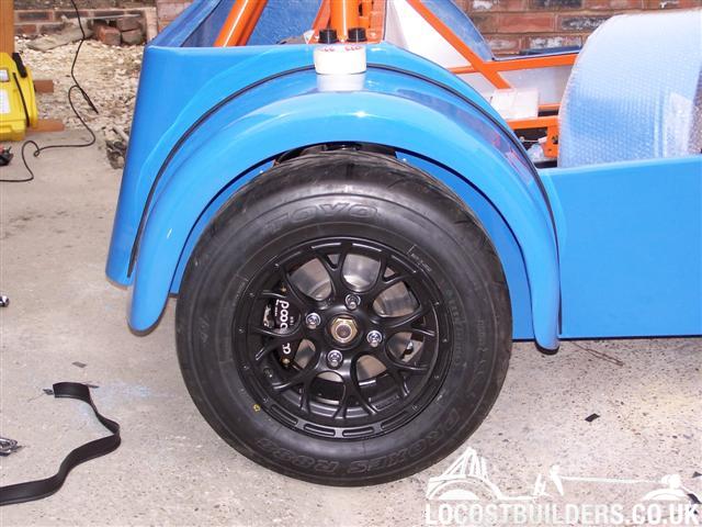

perksy
posted on 26/12/07 at 04:06 PM Reply With Quote
RIALS on Mine...
Aico
posted on 26/12/07 at 04:11 PM Reply With Quote
Those look amazing. Howmuch to those rims cost?
perksy
posted on 26/12/07 at 04:28 PM Reply With Quote
They're about £200 a Rim
They weigh 4.9kg a wheel (13x7)
You can have Silver centres instead of Black if you want...
[Edited on 26/12/07 by perksy]
