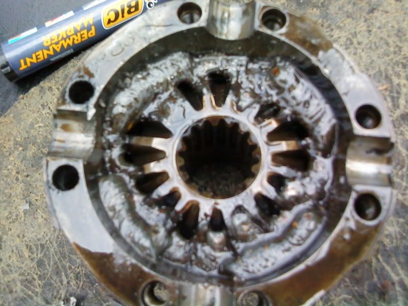

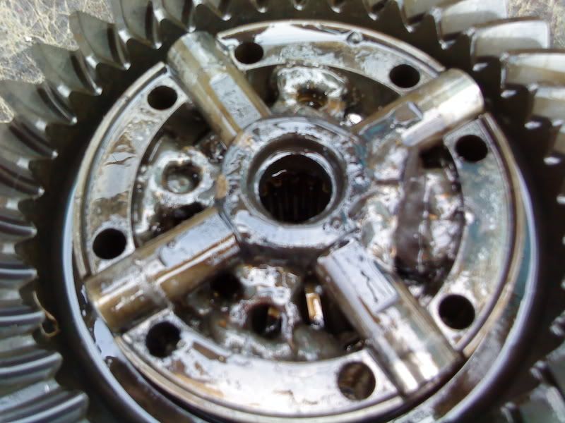

owelly
| posted on 16/6/08 at 09:46 PM |
This is what the inside of my 'LSD' Atlas looks like!!!
One side of the welds had failed which gave me one wheel drive and lots of banging and shuddering as the shrapnel was sloshed about!!
http://www.ppcmag.co.uk
Volvorsport
| posted on 17/6/08 at 01:50 PM |
what are the welds for ?
is that a lincoln locker ?
www.dbsmotorsport.co.uk
getting dirty under a bus
DIY Si
| posted on 17/6/08 at 04:46 PM |
Looks like someone has welded the diff solid. That wouldn't have helped at all.
owelly
| posted on 17/6/08 at 09:21 PM |
Yup! It was a cross pin diff that someone had welded-up. When I got the axle, I had a quick peek inside the diff cover, saw it wasn't an open
diff and that the wheels turned the same way, and did a gleefull jig. I fitted the axle, complete with the disc conversion that was already attached,
and off I went. Sideways.....
I'm now fitting another Atlas from a 2.8 Crapi. It's an open diff but it seems to work!
Volvorsport
| posted on 18/6/08 at 09:57 AM |
yeah , that wont do your handling any god whatsoever , in fact only good for drifting .
lincoln locker = welded diff
