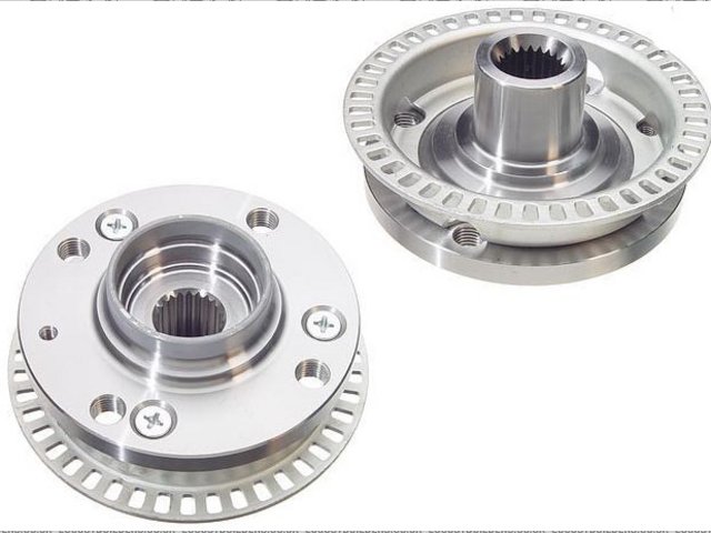

Front hub:
[Edited on 14/11/05 by Rorty]
Cheers, Rorty.

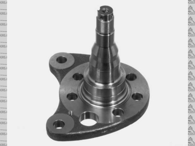

Rear stub axle with calliper mount:
Cheers, Rorty.

Rorty
| posted on 14/11/05 at 04:52 AM |
quote: Originally posted by Lozec
Rorty,
From what year/models are the items on the excellent pictures?
Is there any reason why not using the front hub in all four corners?
The parts in the pics are from 99 to present, but as far as I can ascertain, all Mk III stuff (from 91) will do the job.
Am I imagining things, or is there someone on the forum who works in a VAG spares dept? Confirmation of part numbers would be terrific, though
I'm pretty sure my research is good.
The front hubs are totally different to the rears; the fronts are splined onto the stub axles which spin in bearings in the uprights, whereas the
rears are of the conventional kind and have bearings that spin on the rear stub axle.
The calliper mounts are different too.
Also, if someone wanted to use a car as a donor, then using the same hubs all round would necessitate two donors.
Anyway, each end is perfect for what it does, so I don't really want to re-invent the wheel or introduce more custom machining than is
absolutely necessary (which, on the rear, with standard parts, is nil). The front end only requires the upright to be fabricated which is a very
simple job if I do a keyed upright.
The only parts that would require machining (turning) are new bearing housings, which are basically just a short length of pipe with two circlip
grooves.
It really doesn't get much simpler.
