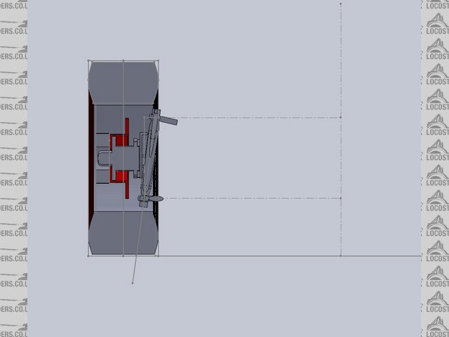

Front suspension design problem
  concept suspension

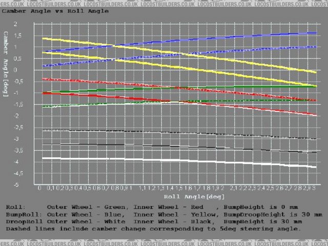

Based on information found on this forum, I want to design a suspension with less then 10mm scrub, kpi of 7,5deg, camber of -1,5deg and a wheel with
ET35. Tyres would be 185/60 R13. (I know the rims aren't right)
I used the Cortina hub and spindle and Ford 245x12mm disc brake, but I have some clearance issues. Mildy said.
Any suggestions?
[Edited on 11/12/08 by ettore bugatti]

You are reliant on pre-maid hubs so there are limitations.
One way to reduce the scrub is fit different offset on your wheels, but this might not be possible depending on clearance issues.
That is why I made the hubs for the F1-2 and MotaLeira.
As to drawing programs, do you need one?
You can spend days just learning how to use a program or you can use pencil, paper and a ruler. Much simpler.

ettore bugatti
| posted on 11/12/08 at 10:20 AM |
Im using Autodesk Inventor with the pen and paper extension as you can see .
Hmmm, I thought making your own uprights would be a major step.
Now Im thinking that using hub and stub axle from a donor, you will end up with a replica upright of the donor...

m8kwr
| posted on 11/12/08 at 12:10 PM |
I have got the same problem, or worse then yours - i have got a scrub radius of 39.05 with a wheel offset of 42mm. the KPI is 7.88 degrees
I have been doing trying to do some reading up on the scrub radius, and why i people prefer it to be zero.
A lot of front wheel drive cars have scrub radius to make parking easier, as the wheel rolls as it is steered.
You need to make sure the scrub radius each side is exact... or that can cause problems at high speeds - assuming one side will rotate more then the
other.
I am at a lose what to do, i either need to design my own uprights, as the ones in the picture are pre-brought ones - but was hoping i think they
would work- or i modify these somehow to increase the KPI to reduce the scrub radius.
I wish now i would of gone with the normal 7 front uprights (cortina), and hope that would of been ok, but i am unsure what the scrub radius is on a
7???

ettore bugatti
| posted on 11/12/08 at 05:05 PM |
@CaptainJosh:
The disc idea might give a little bit more air.
@m8kwr: Are these uprights Raceleda geometry?
And what hubs, brakes are you using?
I think you have a better proposition then I have.
You you would use a wheel with a ET of 18 (Peugeot) then you scrub radius is around 15mm, not to bad.
On a Locost with Cortina uprights the scrub radius is massive. There is a picture on this forum.

britishtrident
| posted on 12/12/08 at 08:08 AM |
On tarmac surfaces scrub radius really dosen't matter that much in fact if you have too low a scrub radius the steering will lack
"feel" and feed back. --- In any event you are going to find getting a low scrub radius pretty well impossible t with Cortina front end
parts because the Cortina upright dosen't have enough kpi designed in.

Bob C
| posted on 12/12/08 at 05:54 PM |
That first drawing says it all, you'll only get the scrub radius down by locating the bottom balljoint inside the disc.
Why not use some different uprights? MX5 ones are (rightly) becoming popular now, those cars were designed with zero scrub radius. Then you're
set up for a nice IRS too......
ettore bugatti
| posted on 12/12/08 at 09:51 PM |
Well, that's what Im designing right now
A custom upright using Cortina hub and stub axle, but it's not worth it. It would just look like a cortina upright with these parts.

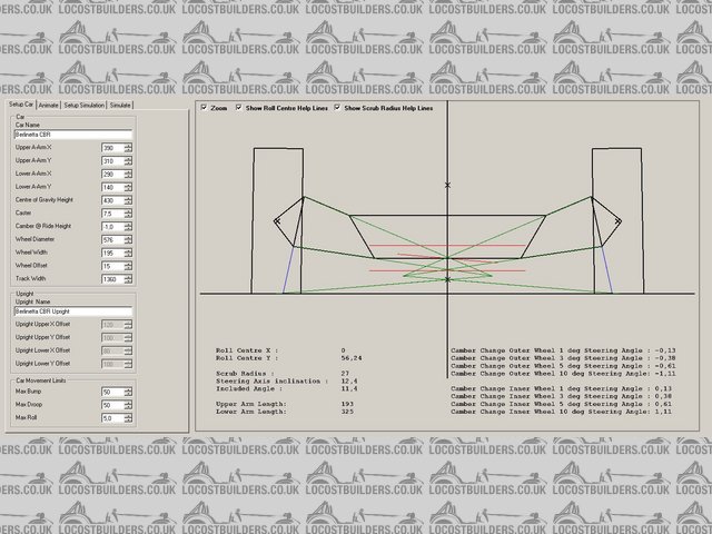

ettore bugatti
| posted on 8/1/09 at 09:43 PM |
Hmm, this could work.
Changed the kpi to 11 a 12 degrees, a bit much.
What do you think?
