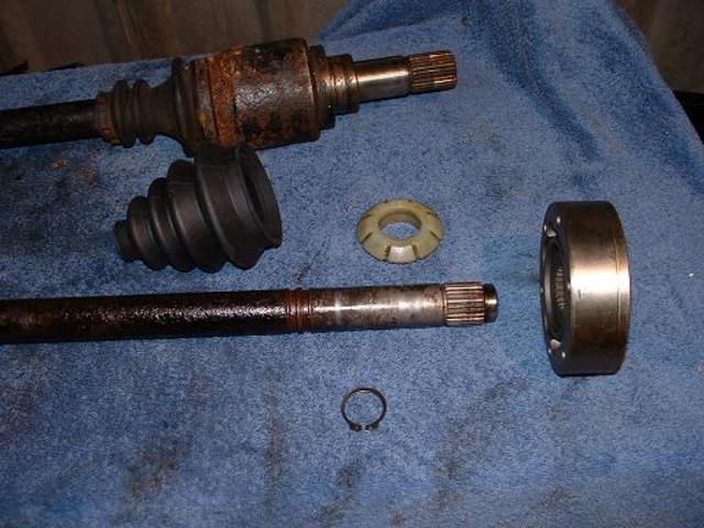

maximill666
| posted on 11/1/09 at 02:30 PM |
Lars,
All you need to do is change the push in CV joints for Lobro bolt on ones from bolt on shafts.
That is what I have on mine, a 3.62 LSD diff with drums, using push in shafts with lobro joints.
  Rescued attachment Shaft 2.1
