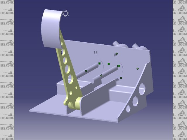

Currently i am in the process of designing/fabricating a new design for a pedalbox with double brake MCs and balance bar. Attached is a CAD
image...

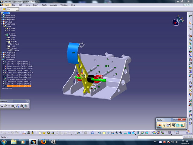

I am in the design process. I hope in a few days i will have the design 100% ready. I attach an updated CAD image.

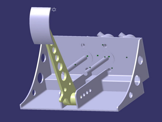

An updated image of the new pedalbox. What do you guys think?
