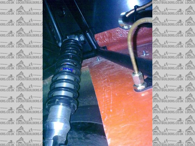

well anyway was looking over the front and noticed the offside was more compressed than nearside (about 2cm) this is an inboard set up and the
pushrods are both the same length
now the springs are the same length and so are the dampers first thing i checked once i noticed it.
i've attached some pics
is it just a case of the springs being different poundage they are both marked as 175lb

Ok i built the car, i've only had it laser tracked so far.
the first pic is with the platforms wound all the way down, strange how the offside is more compressed

Johneturbo
| posted on 9/5/09 at 09:46 PM |
ok thanks for the ideas guys
philw, yep they are protech i'll check how they feel once i've removed the springs
Agriv8 in the first pic both springs platforms were wound all the way down, but to get them looking the same( same compression of the damper)
i've had to wind up the drivers side to get it looking the same.
