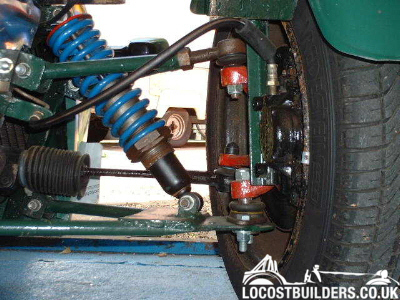

| posted on 16/3/04 at 10:28 AM |
Mine have a washer on one side and a nut on the other side of the bracket to hold them. some are fitted through the side panel in the same way, it
holds them firmly in place so they don't turn when you attach the solid pipe union.That's why it's easier if you get the longer
threaded ends.
http://www.locostbuilders.co.uk/upload/brake_pipe.jpg
[Edited on 16/3/04 by Peteff]
