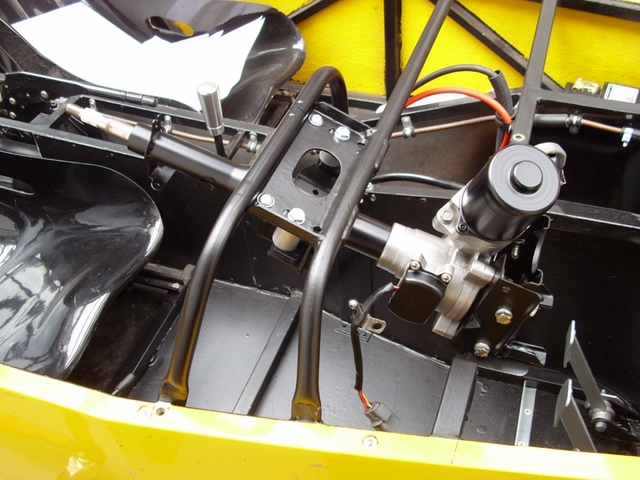

40inches
| posted on 28/9/09 at 10:46 AM |
I have fitted a MGF column, it's smaller and lighter than the Corsa. It needs a pot wiring into the ECU loom to replace the speed sensitive
input, this gives the choice of degree of assistance or non at all, could fit a girly button instead Do you need power steering? probabley not, but
nice at parking speed then switch it off, or if some disability means you have weak arms.
  Top view
  Nacelle and wheel fitted from below
