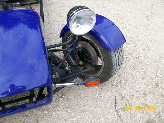

cortina hubs, is this right
ive got some cortina hubs and was windering if the disc fits this way

Daddylonglegs
| posted on 30/11/09 at 04:31 PM |
2nd one is correct.
The hub carrier will then sit inside the recess in the disc. Like so:

Right end - wrong way round

thepest
| posted on 30/11/09 at 06:37 PM |
the disc goes through where the wheel bolts tighten
02GF74
| posted on 30/11/09 at 07:38 PM |
definitely the second one - you want the disc as far away from the wheel flange as possible (checked haynes as well as car)
RAYLEE29
| posted on 30/11/09 at 10:56 PM |
Definately pic2 some of the above must think cortinas are fwd lol Ray

greed1
| posted on 30/11/09 at 11:21 PM |
would the caliper not be to close to the wheel that way
i have mine as pic 2 and looks fine

Daddylonglegs
| posted on 1/12/09 at 08:41 AM |
If you put it on as in picture 1, you won't get the caliper to fit anyhow.
(Unless of course you make your own uprights as I've just noticed in the second set of piccies - Doh!)
