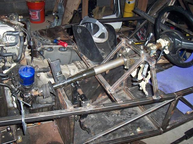

I think I made a pedal box that works
Ok, finally after a few changes I think I have mead (or bought) a pedal box I can work with, Now I just ahve to cut the old one out, and redo the
steering column, here's photos:
Out with the old
  bad pedal box
And in with the new:
Image deleted by owner
  triple master cylinders
Oh yeh mr Grabber, I also have an adjustable arm mount.

Derf,
Looking good.
Are those steel struts between the brake lever and the brake piston arms thick enough? They might need beefing up to avoid buckling when you need to
stamp on them perhaps?
regards
Dave
derf
| posted on 18/5/04 at 01:08 PM |
Not at all strong enough, but I didnt want to finish it off until I have the pedals set in stone and am happy with them. I think these will do it, I
just have to box and seal it off.
