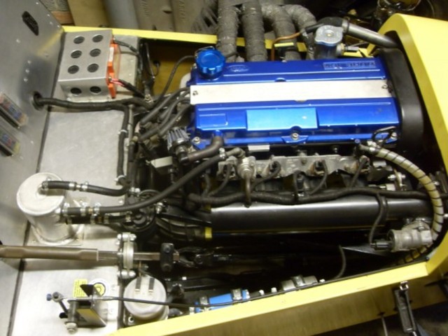

Where have you guys sourced the full bearing kit that supports the steering column at the pedal box?
Does anyone have one available?
Andrew
OK, so I have found them on eBay, but how should they be mounted? Is it inserted into a fabricated piece of flat plate?
[Edited on 5/3/11 by goodguydrew]

SBPFL205 SLFL STEEL OVAL BEARING 25MM BORE on eBay (end time 08-Mar-11 20:44:42 GMT)
There may be cheaper, its just the first one I found.

Does your column go over or through the bulkhead ? Mine is over and I just spaced it away from the plate that had the rubber bush through it.

Simplybearings.co.uk £10.63
link
Is the one most of us used. Photo showing how I've mounted mine:

| posted on 31/3/11 at 08:48 PM |
Closer pic (posted in reply to question from 'Mads'
