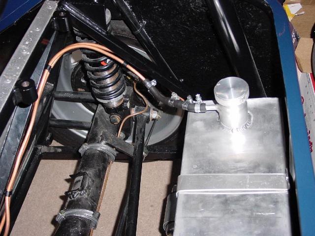

I was lucky the original tabs were still in place but even so I made sure that I slipped a piece of rubber pipe over the brake pipe in the location of
the clip. I dont see why you couldn't do the same but use metal cable ties around the axle.
RD
Like this but this was before I put rubber pipe where clips are.
  Brake Pipe
[Edited on 31/3/11 by rallyingden]
