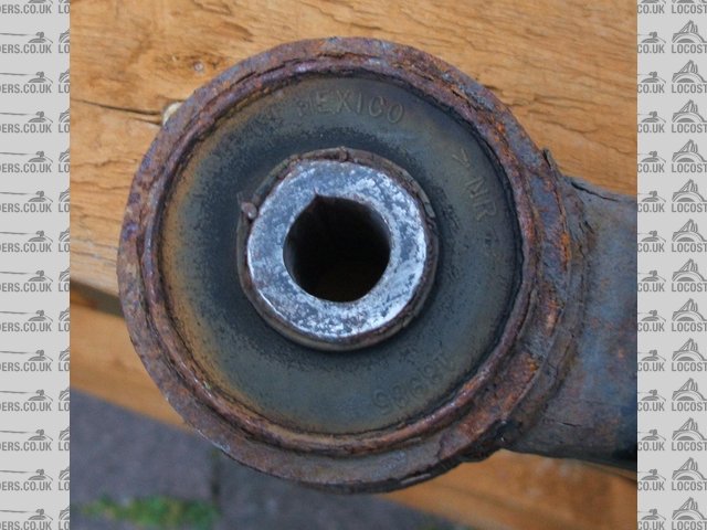

I replaced this bush on the jeep back axle less than 1000 miles ago, and it has fallen apart again. Its not obvious but it was the sort that had a rubber bar across the middle rather than solid rubber all round, unlike the front one that was solid (second picture).
Have i abused it when fitting, or do you think it should be solid like the front one? Sadly, i order another this morning from a jeep part supplier, and i suspect the new one will arrive tomorrow the same.
any ideas?! Cheers!

Did you tighten it up when it was off the deck, I always try and do them up on the ground if poss, other than than I dont have a scooby.

Is it like one of those cortina void bushes for the rear axle?
I think there is a right way and wrong way to fit them - not sure what the right way is but if the 'bar' is not in the correct plane then they do fail quickly.

As above, you losely fit, then lower the car and bounce the car until the suspension has settled at its normal ride height, then crawl underneath and tighten.
Fail to do this and the rubber will be twisted when standing and every bump you hit will try and rip it apart as you are now trying to turn past its design limits.

that will be it. I thought i had fitted it the wrong orientation but it seems broadly correct, however i did tighten it up in the air. Cheers folks! Only took about 11 hours last time... Im going to take it somewhere to get it pressed in properly!

All of the above but also with void bushes you have to be sure the bush orientation is correct.
In addition some non-OEM bonded rubber suspension parts frankly C*** but even those I would expect to last more than 1,000 miles.

Another vote for loose fitting until on the deck, and also orientation.

In fact you can see in the first pic that its about 45 degrees out. Ah well! A little knowledge etc...
