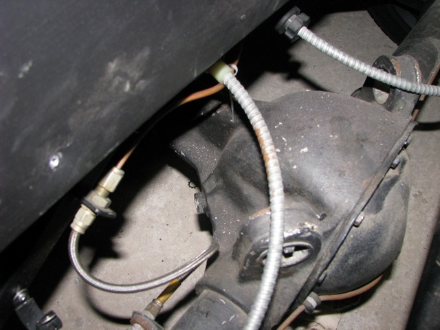

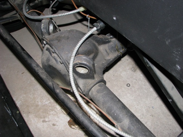

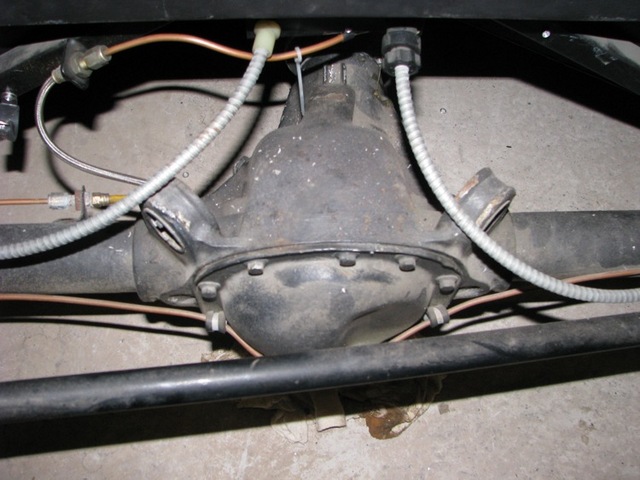

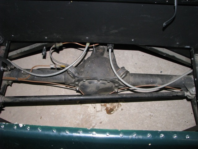

| posted on 27/12/11 at 07:33 PM |
Can you post a pic of the diff from the rear.
If it's the MK5 Cortina axle that I have (e.g. Koln) then it will have loops each side of the diff at the top for bushes.
See djtom's pic:
.jpg)

| posted on 27/12/11 at 08:35 PM |
Okay so looks to be a Koln. Unfortunately not the "preferred weapon of the aggressor" from a BHP point of view.
I'm currently thinking of a swap to Sierra diff etc. like djtom (hence the pic) since I'm looking to up the power on the Duratec.
What's your reason for you identying the axle (if you don't mind me asking)?
