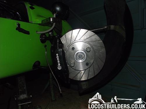

Brembo calipers of Alfa 166 3.0L V6
Discs of a sierra cosworth 283mm
Had to machine cortina hubs, Remove disc mounts as discs mounted on front of hubs now and take 1.8mm of the large OD so cosworth disc fit over the hub.
Fabricated new caliper mounting brackets.
