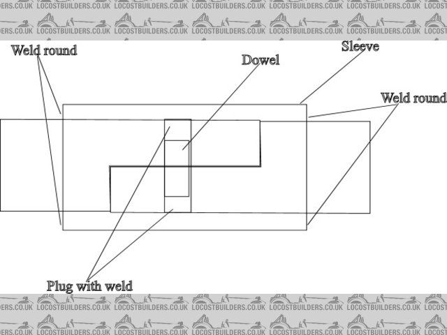

| posted on 23/8/04 at 10:26 AM |
When I was planning something similar I was going to do it like this but the idea was shelved for a simpler live axle chassis.

JB
| posted on 24/8/04 at 11:49 AM |
Welding
Try not to weld in a complete round. This puts a weak spot in one place on the shaft. It is far better to put a slash cut on the end. This gives more
weld area plus avoids the stress raiser in one place.
elding into a hole (rossette weld / plug weld) is a very good idea.
Pre heat the work to dull red and allow to cool slowly.
Welding shafts is generally not a good idea due to the high grade of steel used.
Another option is to sleeve and silver solder or sleeve and use a high strength retainer sush as Loctite 638. You will have to work out the shear area
and strength.
John
