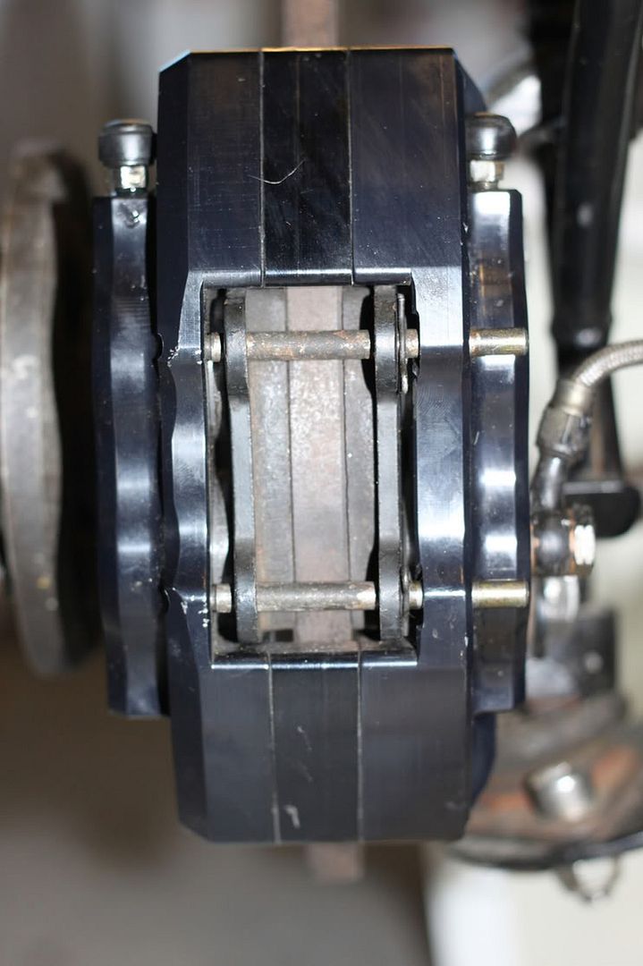

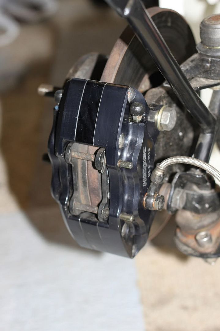

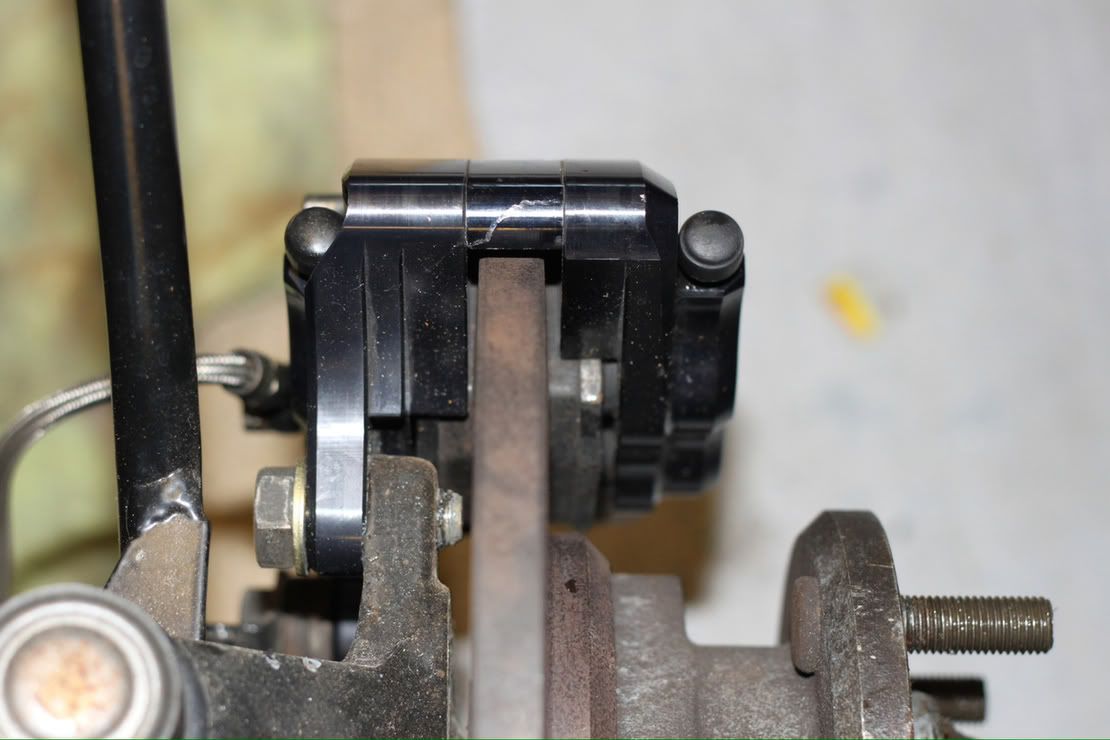

took some pics tonight, would the way the brake hose goes create a air lock with it going from the top in?
owelly
posted on 10/4/12 at 07:52 PM Reply With Quote
One of those piccies gives the inpression the pads are not square in the caliper wgixh suggests its not square to the disc or the disc isn't seated square to the hub?
