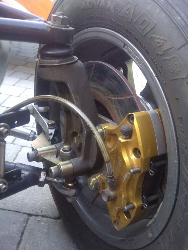

Hello All,
I'm trying to get a replacement brake kit to fit my Fury... i'm pretty sure that i have mk2 escort hubs, but i have unidentified Raceleda (maybe Sierra) uprights. Pic below:
My issue is that i need to know where the standard brake caliper mounting holes are on a standard Mk2 Escort upright / strut, so i can compare this to the brackets currently on the car. Presumably this is denoted as 'Bolt circle diameter' relative to the stub axle with a spacing between them?
Does anyone have a drawing or can provide the required info from memory? I'm trying to establish whether a rally design brake kit for a Mk2 Escort is going to have the right caliper mounting bracket for my application.
Thanks for your help
