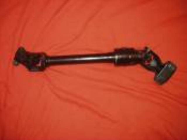

Thanks for the reply. The shaft on the lower part of the column is 22mm diameter. The splined UJ on the end is too large a diameter for the splined
stub on the rack though. Sounds like the lower part of the column on the 4x4 is different to other Sierra's.
In which case, am I correct in thinking the easiest solution is to get a lower steering column from a 'non 4x4' PAS Sierra and that should
bolt straight on to the existing column at the top, and the Escort rack at the bottom?

Yes, with a complete column from a power sierra, and the lower joint from a non power sierra you should be fine.
