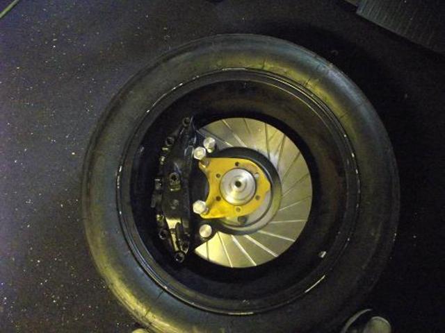

You can make any caliper fit as long as your disc O/D and thickness are correct.
[img]
  Brembo brake upgrade
[/img]

po79
| posted on 9/7/12 at 07:41 PM |
I have been thinking for a while about using Peugeot 206 calipers didn't really think about the older model pugs.
This is all going on to a completely differnt beast!
Poe.
[img]
[/img]
[Edited on 9/7/12 by madteg]
The difference being that the 205 ones will bolt straight onto the uprights
