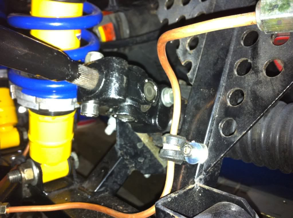

My description is wee poor I know, I'll post a picture in a bit.
mazie
posted on 19/9/12 at 06:20 PM Reply With Quote
mazie
posted on 19/9/12 at 06:22 PM Reply With Quote
Sorry for the image size but i cant resize on this phone. Forgot to say I have the other half of the splined shaft you can have, just the postage cost to you.
