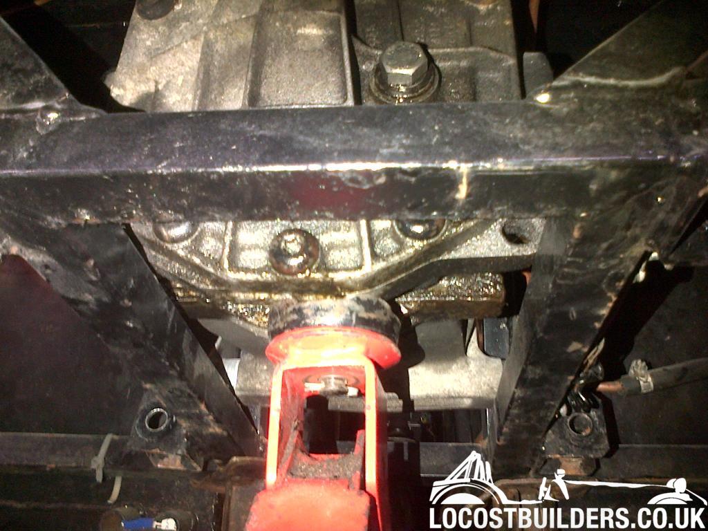

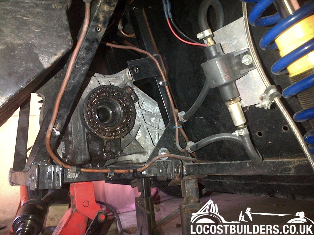

Hi all, I've got to replace the knackered seals on my diff and they wont come out easily so removing the diff is the best course of action.
Although i cant seem to see how its going to come out with the room available? Any suggestions?

Jacko I've tried every which way I can think of ( bar one of those removal pullers) and it won't budge, I've done loads of these in
the past on various cars and this ine is by far the most difficult!

Seals don't look completely fooked so you can't have been trying very hard Get a level under the lip and pull; As it distorts
it'll become looser.
That looks like and older version of the IRS diff cage (it's smaller that the later ones) and I think it needs the fuel tank out and the diff
comes out through the back of the cage.

| posted on 27/5/13 at 06:52 PM |
you should see the other side seal that one well fooked!
I cant get the fuel tank out from below its been dropped in pre-tub fitment and its too large (9gal) to tank out from above unless I want to remove
the tub and as you know that's a MAJOR job.

Ill pick one of those universal pullers up from machine mart and give that a try. The diffs not coming out any way I try, shame little did she know I
was going to nick the other halfs X5 steam cleaner on it before painting .
