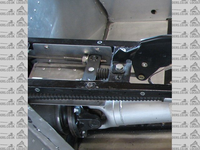

I'll post a pic of mine but having trouble uploading at the moment.
Smoking Frog
| posted on 7/7/13 at 12:32 PM |
Uploaded sorted picture was too big.
I made a balance bar for mine. Two lengths of M10 threaded bar drilled through the centre with nipples welded (molten lead would have been better) on
the end of the cables. Two bits of flat bar with M10 nuts welded in and two more nuts to lock it off.
