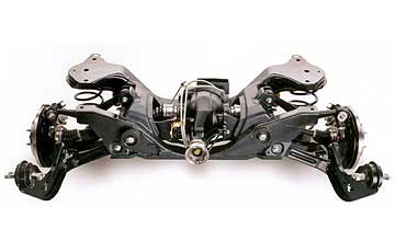

jacko
| posted on 10/9/13 at 03:52 PM |
Don't forget the Nissan skyline diff very strong
  rear axle
[Edited on 10/9/13 by jacko]
