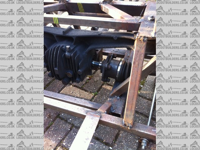

Hi,
I was always under the impresion that the rear MX5 differential was not meant to come apart with ease.
Whilst i was moving the car out the garage last weekend the one of the cogs that links the drive shaft to the diff popped out? Should this happen and
if so how do i put it back? I have tried a simple push but it only goes in so far. I didnt want to give it a whack as it looked like if it is supposed
to come apart then there is probably some logic behind it rather than just a swift twatt with the mallet.
Currently it looks like this.
  Dif 1
  Dif 2

| posted on 27/4/14 at 06:01 PM |
well have you pulled it all the way out is it held in with a circlip or other fixing bearing in mind that will be how you dissasemble it anyway so
probs alright have never had 1 in bits so somebody else will have better answer
Slimy38
| posted on 27/4/14 at 06:20 PM |
The MX5 diff has stub spindles that are just locked in with a circlip. To reinsert requires the skilled application of 'summat heavy'
... you do just tap it back in place. The little flared collar is meant to sit inside the oil seal lip as a guide on how far it needs to go back
in.
Under normal working the distance between the diff and the rear upright doesn't change (or at least not very much), so there are no forces
present to pull it open. However, I still needed to get a crowbar on mine to separate the stub spindles from the diff, so that does suggest yours
wasn't clipped in.
Have you had it apart before? Can you still see the circlip on the end of the spindle, is it intact?
