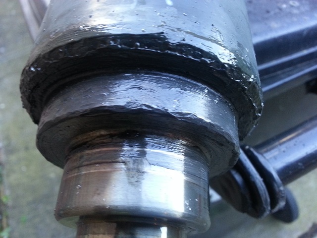

So, further to the above I'm starting to think it's not the diff, but grease leaking from the CV joint. I removed the offside driveshaft
tonight and was faced with this: -
  CV
  Diff
Looks to me as though the seal is in tact (thought I'll replace it anyway whilst it's apart). Looking at what's there, it does
appear to be grease rather than dirty oil. I've cleaned the can, and there's no obvious sign of grease egress though of course it could
have been doing it slowly for a while through a tiny gap?
Based on what I see here, do I assume there's enough grease still in there, take a hammer to it to try and re-seal the end of the can and stick
it back together (worst case it runs a while and then I need a new CV if grease does happen to be low - certainly don't think it was making any
noise), or cut the can off now and replace/repack?
Doesn't explain why I've had oil coming from the breather though. What would cause this? I've not noticed it before (and not
topped it up recently). Could it just have been over exuberance? ( I was having particular fun, and a few seconds quicker per lap than last time out
) Is there anything I can do to check the diff out without dismantling it? Is there likely anything that could have gone wrong inside the diff to
cause it to throw oil?

I did think it was a bit thick and emulsified looking to be diff oil.
You should have enough oil in the diff if it is full to the fill plug lower edge.
As far as the driveshaft goes - any bodies guess....
