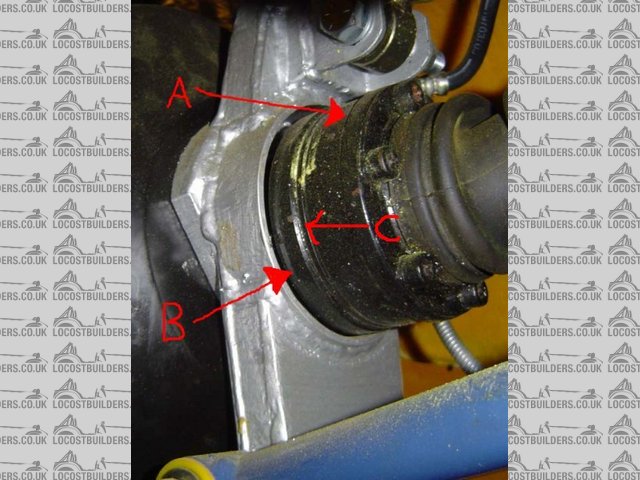

Where does it actually split? Is it at A?

Graham
theconrodkid
| posted on 31/12/04 at 06:12 PM |
close but no cigar,its the grove betwen a and b

So that would be "C" then!
Can anyone see a problem if I remove a little bit of material from the area marked "B" to fit the upright?

DEAN C.
| posted on 31/12/04 at 08:11 PM |
In a word NO!Just take it off as evenly as possible mainly to make it neat and balance ok.
A lot of us have had to remove the ABS ring from the same area in order to fit the shaft into the hub carrier,did mine in the lathe no probs.
