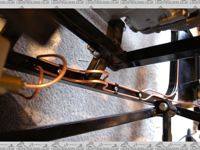

posted on 18/10/17 at 08:09 PM Reply With Quote
As above with loggyboy
here are some of mine

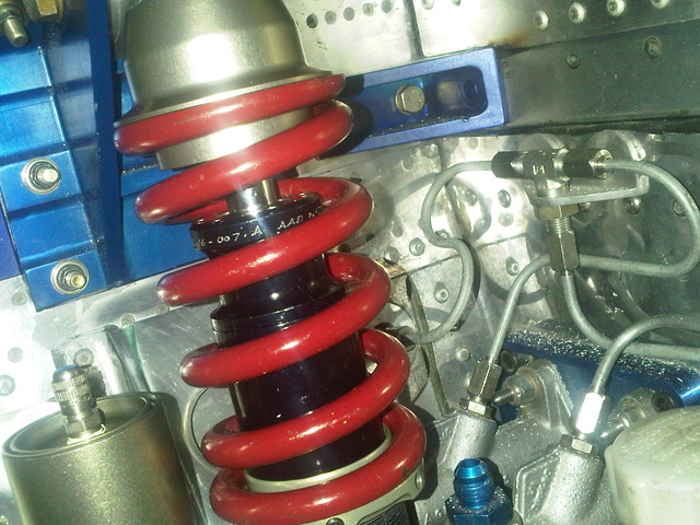

posted on 19/10/17 at 07:55 AM Reply With Quote
"loggyboy" and "mackei23b" - very neat looking pipework!
Mine didn't look quite so neat, but did work perfectly well.
Front brake pipe routing
