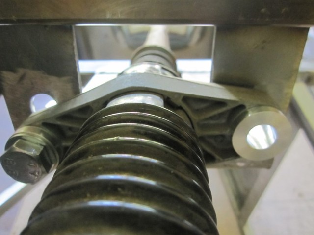

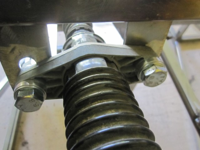

I'm in the process of rebuilding an old kit and am ditching the original Triumph steering column which is like a spear! I've managed to get hold of a Sierra column with switches cheaply and I was just wondering how they are usually mounted. I know the mounting is done using the diamond shaped part but the holes either side are pretty large, are there bushes or something you can get to go in there?

In my mk1 Sierra the bolts are m10 but the washers are oversized - like penny washers - and thick, perhaps 8mm.
The column bolts to a pair of brackets under the dash, the Haynes chassis design replicates these brackets.
To me this does not seem an ideal mount, but it does allow a fair bit of adjustment and in practice it must allow more than enough clamping force.

Hi,
To be on the safe side, I had two alloy hat-bushes turned on a lathe by a friend from the Haynes forum, so there is no gap between the bolts and the mounting homes on the steering column.
Hope that will help

Thanks chaps, Voucht I was thinking of doing something similar.
big_wasa
posted on 19/3/20 at 04:58 PM Reply With Quote
Yep that's how I did mine.

I assume there's no need to have them metal - they're just spacers. If lathe access is a problem could you get a length of PTFE rod or similar at the closest size, sand it down and drill for the bolt with a bench drill?
