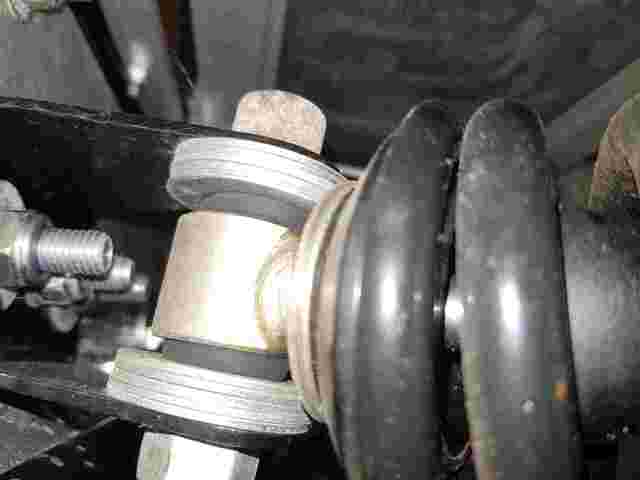

peter_m7uk
| posted on 4/12/23 at 02:10 AM |
Just to follow up on this, I had a look at the ends of my dampers to see how they're mounted and took the attached pics. I believe they are
"top hat" bushes where the tube can turn within the rubber. Maybe you'd want grease between the metal tube outer surface and the
rubber inner surface? Or would you expect the rubber to be bonded hard to the tube and the "eyes" on the end of a damper? I don't
think that's the case.
  Damper Mount 2
| posted on 4/12/23 at 07:41 AM |
That still looks like a mentalistic bush. if it was a top hat then the outer diameter of the bush would be the same as the metal housing. Only going
from the photo they look in good shape. I'd just make sure the bolts are done up tight. WD40 will stop the squeak and let you identify which bush
is the culprit.
peter_m7uk
| posted on 4/12/23 at 02:45 PM |
I asked Gaz directly. They said that the inner tube is bonded to the rubber, but the rubber is not bonded to the "eye" on the end of the
damper. Therefore there must be some possibility for the rubber to rotate, also I don't think it would matter so much what position you tighten
up the bolt as the rubber could adjust. Thanks for the tip, Mr W, but I've read that WD40 can be bad for rubber?
My other thought is to use grease elsewhere on the units. The suspension noise sounds metallic, so I thought maybe some grease where the springs
touch the seats, also where the top seat "cup" touches the damper body. It seems like there could be a few metal-on-metal points. Anyone
got an opinion on that? Will it help? Or just attract dirt and dust?!
adithorp
| posted on 4/12/23 at 08:59 PM |
Only use silicone grease or spray on rubber components.
Mineral based lubricants will damage them.
peter_m7uk
| posted on 27/12/23 at 12:50 AM |
So in the end, I decided to just lubricate everything and see what happens. I removed both rear dampers, de-rusted the fitting eyes and bolts, then
greased everything and re-fitted! All noises have gone and I have my quiet suspension back Maybe there will be a bit of movement in the crush
tubes, but never mind, it won't be much
