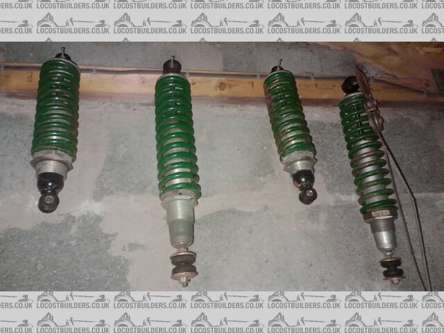

This coilover looks a bit bodged
Can't work out why both sides are like this. Sorry, I bet its going to be massive...

If this is it Shock
Shock
I personally would bin them

Yeah I'd be a bit uncomfortable with running on that. Is this on a recently purchased project or has it appeared on your own car over time?
posted on 26/3/24 at 03:20 PM Reply With Quote
I've had the car ten years and only just noticed! I'll add it to the list of things it requires. There isn't very much that doesn't need doing really!
posted on 26/3/24 at 03:28 PM Reply With Quote
Looking at the rust which seem to indicate heat damage to the paint, it does appear to have been welded after they were originally manufactured. If so I would not run with those as the oil would have been cooked and perhaps the seals damaged inside. Perhaps they had a long thread on them and were altered with an old damper eye. It's amazing what people will do.
I'm sure I've seen a youtube video that shows a swap from thread to eye, but it was on a rebuildable shock. I wonder if some previous owner saw that sort of process and figured a welded version would be 'just as good'.

It looks to me that the welding was done in situ, the weld has gone over the bracket!!!!!!

Look like Robinhood zeemeriders when new, budget and very basic.

I have a full set, unused hanging on the garage wall, but agreed they are quite basic.

As above probably modified by Robinhood themselves…

I would not be surprised the rear ones do in fact have a thread to go through the Sierra trailing arms, maybe that's what they are?

The problem will be mission creep. If I get new shocks and a set up, I'd imagine it wants a new rack too, due to pretty shocking bump steer. Then why not wishbones too, since they might be twenty years old? That's on top of my alloys being a good 35mm wrong offset and no tyre choice in 14s. Add to that the rewire, the pathetic fuel filler neck, the trailing arms being an inch too long, you're not far off a rebuild.
