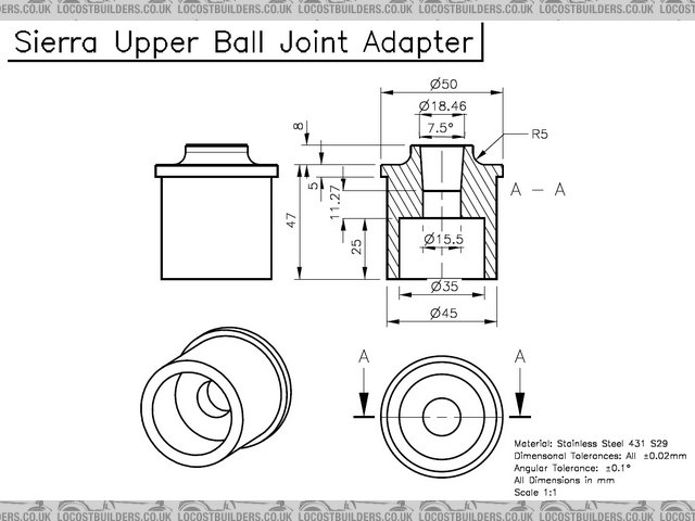

can someone confirm to me the taper on the mk1 transit ball joint to be 15 degrees included angle? i've done a search but i cant find the
conformation of the taper angle.
i'm hopeing to find a tapered reammer to make my inserts but i kinda need to know the taper before i look for one
flak monkey
| posted on 27/2/05 at 09:05 PM |
Drew this a while ago...correct as far as i know:
15 deg included angle...
Hope it helps

| posted on 28/2/05 at 10:24 PM |
Cheers david,
thats a handy pic although it looks like 7.5degree angle! can i take that as gospel?

The included angle is 14.250032 degrees, not 15.
If you don't have accurately mating tapers and seats, the nuts on the taper studs will forever loosen.
If you overtighten the nuts to compensate, you run the risk of breaking the stud while you're driving along.
Cheers, Rorty.
flak monkey
| posted on 1/3/05 at 12:10 PM |
So...i need to change my drawing then?

So it's 14.25degrees then cheers Rorty
