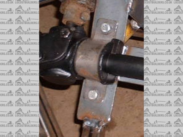

| posted on 2/3/05 at 01:12 PM |
Someone posted that Mk3 Escort rack mounts are the same so they should still be available from Ford. I made some out of 30x3mm strip and wrapped a
strip of inner tube round the rack, I've read about somewhere doing this and it holds really well. I also welded two pieces to the bracket for
sideways location behind the rack.
