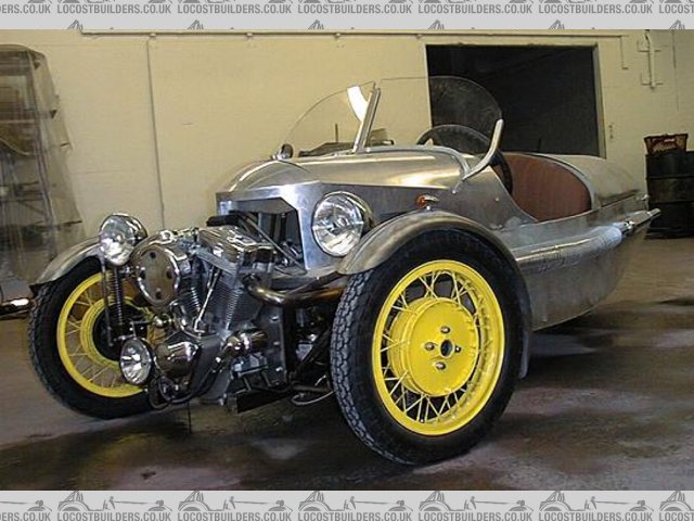

Ford Model A wheels are 19" bolt on units. Maybe a bit heavy... but very period. Below is a photo of a guy that is building a Morgan Trike using
gutted Moto Guzzi wheels drilled to fit drum brake hubs. If money is no object... you can purchase MG TC Wheels from Moss Motors.
