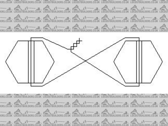

clbarclay
posted on 10/3/05 at 02:25 PM Reply With Quote
An easier way to wire the bolts together is to do as bellow.
Also my eqperiance says that any pair of pliers will do within reason.

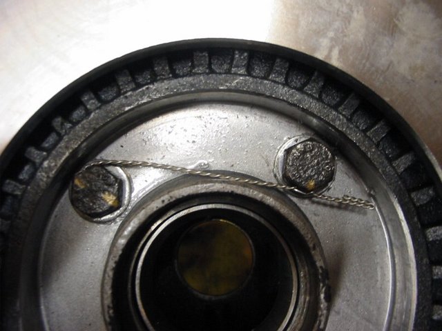

posted on 17/3/05 at 01:46 PM Reply With Quote
A couple of pics of my recently wire locked Brake disks........
wirelocking1
wirelocking1
wirelocking2
wirelocking2
A small amount of 'anti-fret' tape will be applied to stop the wire fretting against the hubs where they touch.
