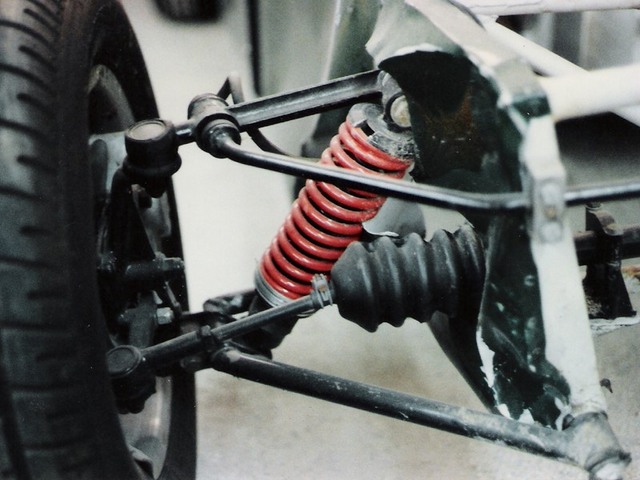

JonBowden
| posted on 16/3/05 at 04:48 PM |
Sean,
I cold not find a decent picture of the early Caterham wishbone, but this is a Lotus Series 2 (It might be a series 3) wishbone.
Jon

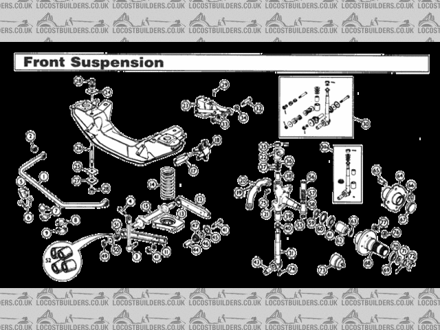

JonBowden
| posted on 16/3/05 at 04:51 PM |
I found this one. I believe it's a Caterham
Jon

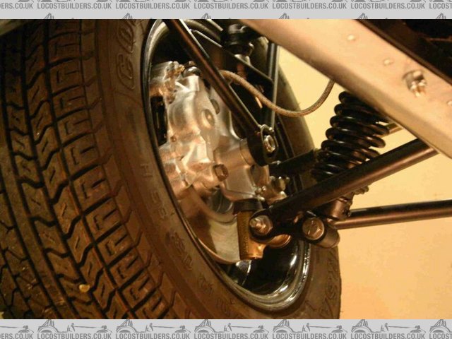

britishtrident
| posted on 16/3/05 at 05:51 PM |
Already been discussed widely in the forum you will find a design for a lower wishbone on in the files area of the yahoo locost group or it would be
easy to adapt the standard Locost wisbones as Ken Walton did on his MGB locost.
Another alternative is making wishbone similar to the ones Spyder make for 60s Lotuses.
http://www.spydercars.co.uk/pg3_spy_tubular_wishbone.htm

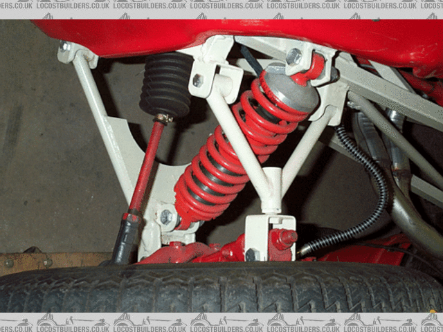

britishtrident
| posted on 16/3/05 at 05:52 PM |
Another picture of the late Ken Walton's car
Sean
| posted on 16/3/05 at 09:43 PM |
Thanks guys that is all very helpful. I will check out the files. I'm not quiet sure what the upper one is doing. Is that a diff ball joint or a
track rod end. Or just my eyes not seeing it properly?

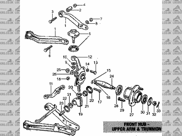

britishtrident
| posted on 20/3/05 at 05:00 PM |
Triumph front suspension
