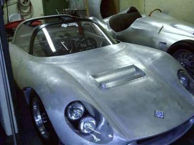

this might interest you. Not much of the upright visible, but a similar alfa based midi
Jon

Would love to see any more pic's you have of this car as it is spookily similar to my design.

Sorry, I don't have any more pictures of the Alfa based car. I don't even know where the pictures came from - If you find any more I'd
love to see them.
