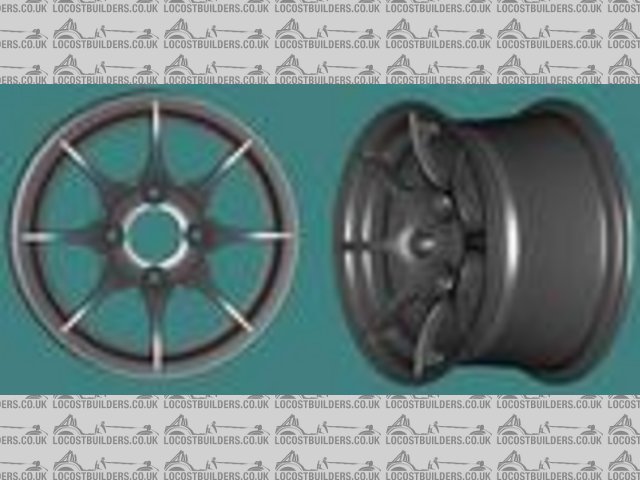

Anyone know what wheels these are ?
Went to stonleigh at the weekend weather was awesome so it was a good day.
Anyway seen loads of these wheels and and cant seem to find them anywhere anyone know what they are ?
  13 inch rim

afaik,
they are caterham's own wheels.
will have a google and get back.
tom
Matthew_1
| posted on 5/5/05 at 07:03 PM |
They are indeed caterhams own new light wheels. They do a 13" and 15" in them
indykid
| posted on 5/5/05 at 07:07 PM |
yep, £90 for 6x13 (4.78kg), £130 for 8x13(5.44kg).
they purty. they cheap aswell! if i'd have known, i wouldnt have bought the PR1s, although it say's they're de dion fitment only, so i
don't know what hubs they'll be.
they also do 10 spoke 6.5x15 for£105.75(5.3kg)
well worth having hubs redrilled for imo
tom

de dion...
... means good old ford fitment (4.25" pcd) and smallish offset (i.e. 10-20mm not the 30-40mm of the modern fords ike focus)
I think this means it's fine for the book dimensions, westfield, stuart taylor, etc but might have too little offset (i.e. wheels stick out too
far) for the sierra based cars like Indys etc (although you can always play with the way you mount your wings, etc).
HTH,
Adam.

dedion caterham fitment is et18 and et23 iirc..
Ned.

| posted on 5/5/05 at 09:09 PM |
My kj jupiter 6x14s are ET19 front and rear. They were standard fit to 80s de dion caterhams.
Adam

wheelsinsteadofhooves
| posted on 6/5/05 at 09:57 AM |
think wheels in original photos are copies of the caterham ones - or other way round. check centre hub on photo - built into wheel, and opening on
c'ham offerings. also c. ones some fancy alloy, and photo ones standard alloy by the look of the finish. all in mho ofcourse, may well be
wrong.
been thinking about the c ones for a while, so am interested in any "locost" alternatives.
