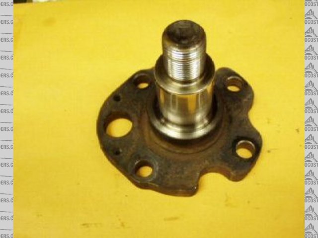

That's where I saw it; on the back of a Mk V GTi.
Incidently, they're ideal for an IRS set-up as the rear stub is a bolt-on affair with an integral caliper bracket.
  Rescued attachment stub_axle-rear_99-04 GOLF,GTI,JETTA 1.8T,VR6,2.0,TDI-DISC BRAKE.jpg
Cheers, Rorty.

This is probably a dumb question, but are those calipers straight swaps for the Ford units. Do they fit straight on a ford sierra hub ?
Bob C
| posted on 21/9/05 at 12:10 PM |
not totally ideal rorty - how do you drive the wheels ? ? ? ? ?
Bob
Rorty
| posted on 21/9/05 at 12:28 PM |
Bob
Doh! Hadn't got around to that part yet!
Actually, I was investigating them for a FWD project recently, using a Golf/Jetta as the donor, but alas, it isn't to be.
Cheers, Rorty.
