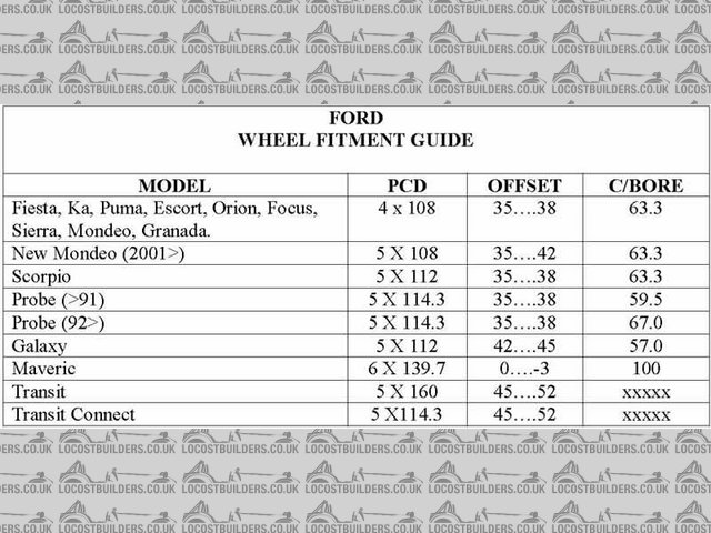

Wheel fitment sizes
I thought this might be usefull to some builders when looking for suitable alloys.

| posted on 5/10/05 at 02:54 PM |
you don't need a 42" screen for this version.
I think cortina and mk1/2 escort are much lower offset, around 15-18 iirc
