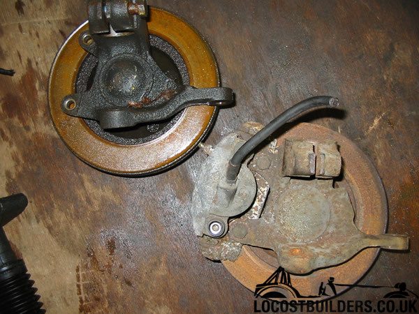

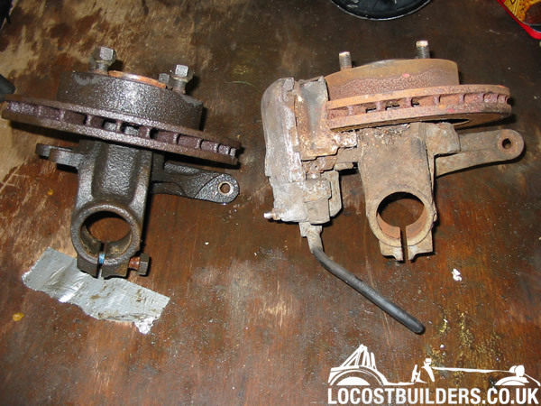

here are the pics i have:
http://www.locostbuilders.co.uk/upload/img_0378.jpg
http://www.locostbuilders.co.uk/upload/img_0379.jpg
http://www.locostbuilders.co.uk/upload/img_0380.jpg
ones is from a d reg pinto, drum brakes etc and the other is from a later rear disc abs car, prob a cvh or dohc, not sure on exact year though.
Ned.
