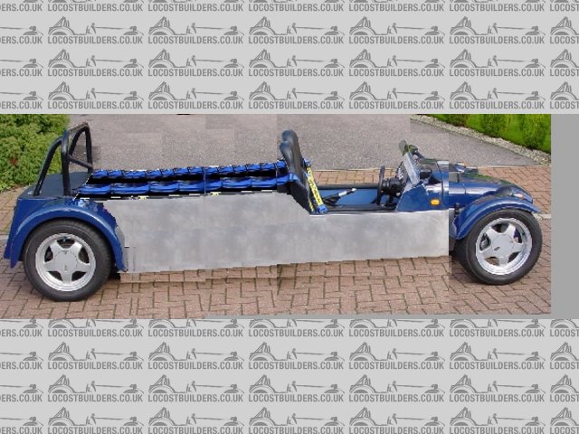

How about moving all the length where bonnet is for a front engined car to behind the seats
You're forgetting that part of the gearbox is in the tunnel at the side of the drivers legs so if you put it all behind the cockpit it would add
that much more to it as well unless the front of the engine went beside the driver. You'd also need to get the clutch cable and gear linkage to
the rear as well, I think it would be an exercise in futility to produce an unusable, awful looking vehicle.
Agreed that it is an issue for a CEC. Not a BEC, though
The Fisher Menace has the driver and passenger seats slightly offset with the engine behind the passenger.
For a CEC, just drop a FWD driveline in the back as per Mojo, Aeon, MK GTR etc
Which is what the thread is specifically about . Also the prop is beside the driver not behind so that adds even more length, at this rate
you'll be sat in the nosecone with the steering wheel behind you.
Hey now there's an idea... hands behind your back steering!!!! That would impress the boy racers!
You're absolutely right I was forgetting that the gear box is alongside the drivers legs. Think it would be easier to just find a FWD engine
gearbox to drop in the back.
