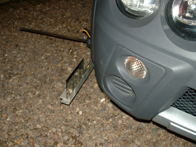

A few people have quizzed me over the tracking gauges that I have made. Here are the pics as promised. The Laser angle gauge was about £9 and you then only require a couple of decent lengths of angle, 2 quick clamps and your wifes vanity case mirror that requires gluing to one of the lengths of angle. Rescued attachment DSCF0144.JPG

nitram38
posted on 3/4/06 at 08:15 AM Reply With Quote
A very simple design, good work!
The only change I would make is to make them touch the rim of the wheel and not the tyre. The tyre walls can be uneven depending on what surface you are on.

Howlor
posted on 3/4/06 at 08:32 AM Reply With Quote
All that you do is adjust the angle of the laser until it strikes back through the centre line of the laser. TThen read off the scale what angle the wheels are at. It is fine for a couple of degrees toe out but anymore and you need to mount the laser on the other side to get an accurate reading as the scale is only 90 degrees.
Howlor
posted on 3/4/06 at 08:34 AM Reply With Quote
I tracked up my mates Robin the other day and got it spot on!
This system works on the rear wheels as well just have to reverse the reading. if you point the gauges backwards.
I will have a think about a 4 wheel setup. I also wanted to try making it measure to the cars centre line so that the wheels can be accurately set to the car rather than to each other.

Howlor
posted on 3/4/06 at 08:52 AM Reply With Quote
I did make a modification yesterday by adding a 100mm high back plate mounted behind the laser. I then drew a vertical line down it through the laser centre line. It makes it a little easier to see when the laser is correctly lined up.

Howlor
posted on 3/4/06 at 03:46 PM Reply With Quote
1 degree toe in is relative to the other wheel not the car. Ideally it would be good to be able to set the mirror side of the gauges along the cars centre line or at least parellel to this. Then you could adjust each wheel to half a degree toe in. Then as long as you had put your steering wheel straight in the first place when you drive it should still be straight. My method unfortunately does not centre the steering wheel.
