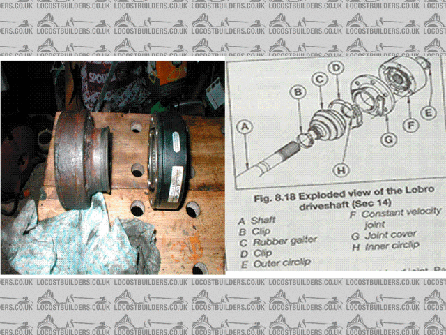

Hi Guys,
Lets try this question again and this time I will try to be clearer.
Below are teh picture of the original CV joint still attached to the Joint Cover (as described in the Haynes manual), next to it is teh new CV Joint
that I have purchased. Also pictured is the relavent diagram from the manual which clearly shows that the Joint Cover (G) is seperate to the CV Joint
(F).
OK heres the question. I can not see how to seperate teh two of them, is it just brute force with a hammer and cold chisel or have I got the wrong CV
Joint?
Please help me.

| posted on 22/5/06 at 05:30 PM |
They should fall apart with a tap from a hammer. Mine did.

| posted on 22/5/06 at 05:33 PM |
Yep, logical tapping with a hammer and punch will see them fall apart.

| posted on 22/5/06 at 06:16 PM |
Yep they should eventualy fall apart. Since you are scrapping the old CV supposedly, you could take the bits out of the middle of it and drift the
cover off from the inside with a piece of wood. Would stop you messing up the edge of the cover if it's really stiff and needs a lot of
hammering.

| posted on 22/5/06 at 06:19 PM |
And oh yeah - when i bought new cv boots from my motor factors, they came with new covers already attached. If you get some like these you wont need
to get the old cover off.

| posted on 22/5/06 at 10:32 PM |
Yep, some gaiter kits come as just the gaiters and some as gaiter with metal bit too.
(annoyingly one of my full cv kits had a faultiliy crimped gaiter and I tried to recrimp it and mauled it beyond repair so I couldn't take it
back, so i ordered a gaiter kit and it only had the rubber bit so I have one old metal bit!!!)
in answer to the question, sharp cold chisel and light taps will sort it out for you, they knock off the joint.

| posted on 23/5/06 at 07:46 AM |
Thank You
Gee I'm just stupid. I did not realise that the CV Joint when inside the Joint Cover, a couple of taps (IN THE RIGHT DIRECTION) and off they
came.
