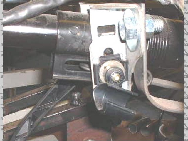

You can see the range of adjustment here
Raz
