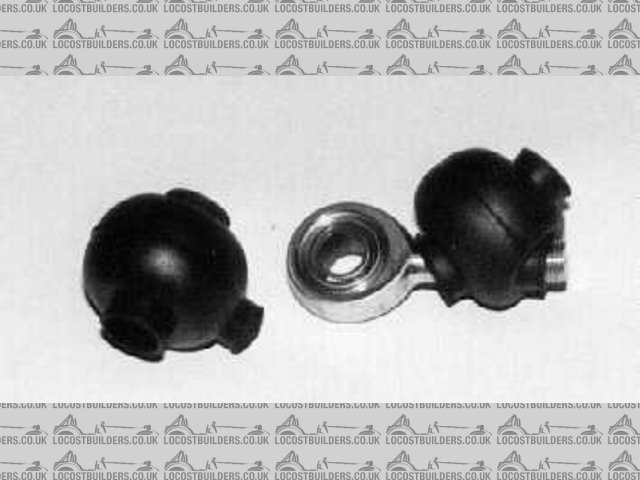

| posted on 9/11/06 at 01:27 PM |
just put on some of those rubber boots to keep all the crap out.
02GF74
| posted on 9/11/06 at 02:49 PM |
looks like a pair of squash balls could replace those things ^^^^ with the appriopriate holes of course.
